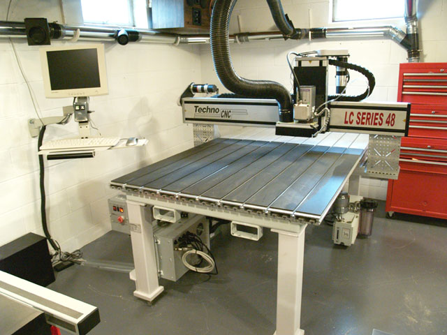

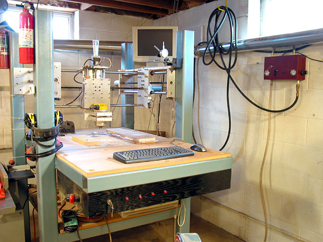

Seems like you're on the right track, Mattia. The machine I built served me well for 3 years. It just couldn't keep up as my business grew. I wouldn't have hesitated to build it's replacement from scratch either, I just didn't have the time.
The only advice I would give is to take your time with it and to buy the motors and drives last. That way you can put all of your remaining budget into them. Go servo if you can.
Here's a pic of my first machine and the current beast.
John Watkins

Mattia, the ground rails and pillow blocks are built to have some play in them so that the rails don't have to be dead parallel for them to function without binding. I would recommend the linear guides every time, but the surfaces they attach to and the mounting holes have to be very accurate, flat, square, etc.
